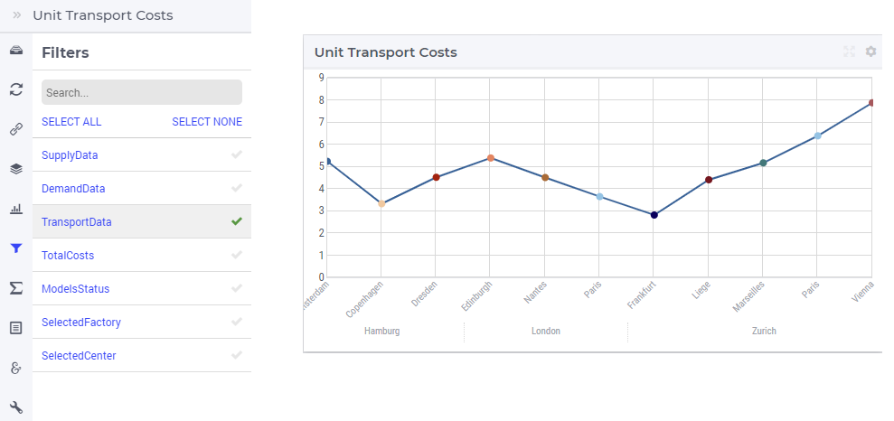

The Line Chart widget is a X-Y plot and represents data as a graph with lines and dots. A typical situation is when a 1-dimensional identifier such as the Demand(c) of a distribution center c in the TransNet application (see the “Quick Start: My First WebUI” section) is displayed like in the following picture:
More generally, a line chart widget offers the possibility to display multi-dimensional data in your model by displaying a dot for each data point in the X/Y-plane. The Y-coordinate of a dot provides information about the value of the corresponding data point. The dots may be linked by lines in between rendering the graph. For example, in the TransNet application, the unit transport costs for every combination (factory, center) may be represented using a line chart widget like illustrated in more details in the sequel. More specifically, we discuss and illustrate below one-by-one the tabs in the line chart’s options editor which may be accessed through the Settings wheel as shown in the picture above.

Next, in the Pivot tab of the options editor, one can specify how the data dimensions are to be organized in the chart. For example, if both the factory index f and the center index c are specified in the X-axis section and the <IDENTIFIER-SET> in the Totals section then the resulting bar chart looks like in the picture below on the right:
One may move some data indexes in the Overlays section of the Pivot tab. In our example, moving the factory index f to the Overlays section results in the following line chart view:
So, now for every factory f there is a line in the chart with a different color. The three lines are drawn independent of each other.
If one moves the center index f to the Overlays section and the factory index f back to the X-axis, then the line chart view shows a line for every center:
Similarly, one may move some data indexes in the Stacked section of the Pivot tab. In our example, moving the center index f to the Stacked section results in a line chart view like below:
Again, for every factory f there is a line in the chart with a different color, but the three lines are now drawn on the top of each other.
