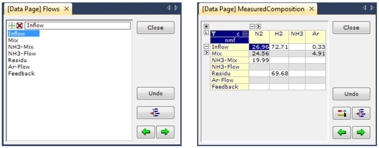

Fig. 22 Data pages of a set and a 2-dimensional parameter
Data pages provide a view of the current contents of the selected identifier. Which type of data page is shown by AIMMS depends on the type of the identifier. The data page on the left is particular to one-dimensional root sets, while the data page on the right is appropriate for a two-dimensional parameter.
Data pages for variables and constraints
For variables (and similarly for constraints), AIMMS will display a pivot table containing all the indices from the index domain of the variable plus one additional dimension containing all the suffices of the variable that contain relevant information regarding the solution of the variable. Depending on the properties set for the variable, this dimension may contain a varying number of suffices containing sensitivity data related to the variable.

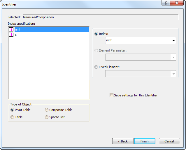

For multidimensional identifiers, AIMMS displays data using a default
view which depends on the identifier dimension. Using the
button on the data page you can modify this default view. As a result,
AIMMS will display the dialog box illustrated in
Fig. 23.
Fig. 23 Selecting a data page type
In this dialog box, you can select whether you want to view the data in a sparse list object, a composite table object, a pivot table object or in the form of a (rectangular) table. Additionally, you can indicate that you want the view to be sliced, by selecting fixed elements for one or more dimensions. For every sliced dimension, AIMMS will automatically add a floating index to the data page, allowing you to view the data for every element in the sliced dimension.
Saving your choice
If you want to always use the same data page settings for a particular identifier, you can save the choices you made in Fig. 23. As a result, AIMMS will save the data page as an ordinary end-user page in the special All Data Pages section of the Page Manager. If you so desire, you can further edit this page, and, for instance, add additional related identifiers to it which will subsequently become visible when you view the identifier data in the Model Explorer.
