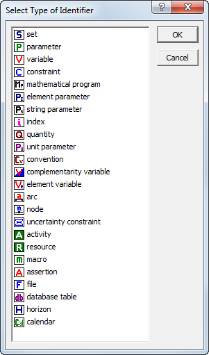

Identifier types
There are many different types of identifiers. Each identifier type corresponds to a leaf node in the model tree and has its own icon, consisting of a white box containing one or more letters representing the identifier type. When you add an identifier to a declaration section of your model in the model tree, you must first select its identifier type from the dialog box as presented in Fig. 16.
Fig. 16 Choosing an identifier type

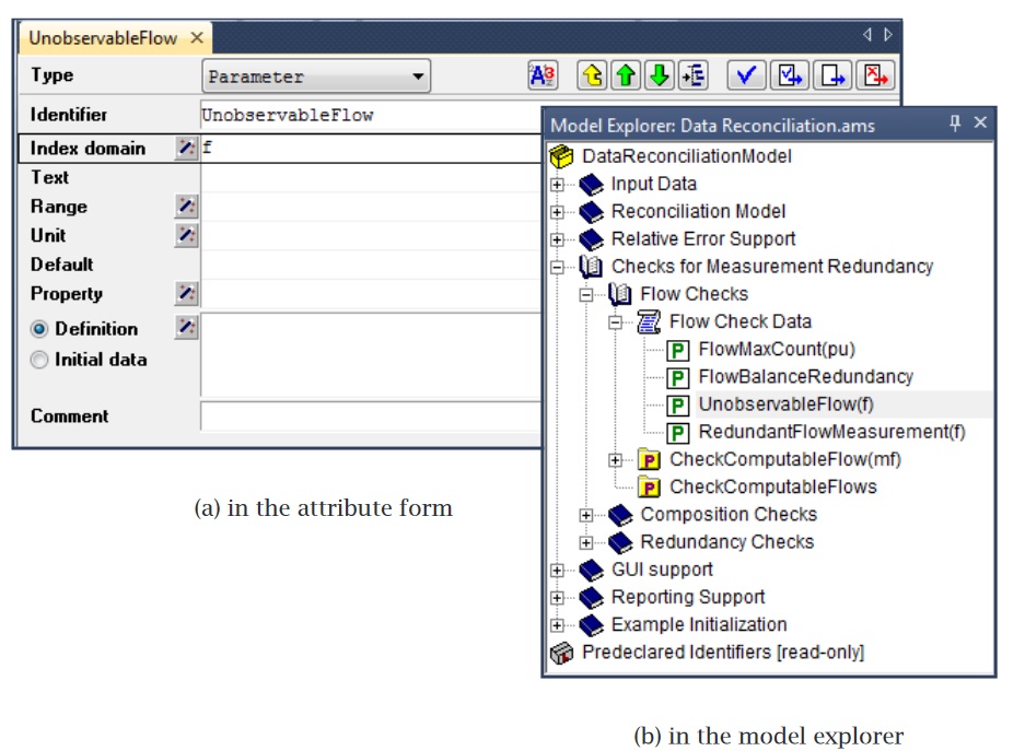

Index domain
In addition, when an identifier is multidimensional, you can immediately add the index domain to the identifier name as a parenthesized list of indices that have already been declared in the model tree. Alternatively, you can provide the index domain as a separate attribute of the identifier in its attribute form. Fig. 17 illustrates the two ways in which you can enter the index domain of an identifier.
Fig. 17 Specifying an index domain
In both cases the resulting list of indices will appear in the model
tree as well as in the IndexDomain attribute of the attribute form
of that identifier. In the IndexDomain attribute it is possible,
however, to provide a further restriction to the domain of definition of
the identifier by providing one or more domain conditions (as explained
in full detail in the Language Reference). Such conditions will not
appear in the model tree.
