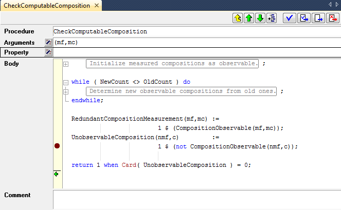

Setting breakpoints in the body
Within the AIMMS debugger you can set breakpoints on any statement in a
procedure or function body (or on the definition of a defined set,
parameter or variable) by selecting the corresponding source line in the
body of the procedure or function, and choosing the
Debugger-Breakpoints-Insert/Remove menu (or the Insert/Remove
Breakpoint button
on the Debugger toolbar). After you
have set a breakpoint, this is made visible by means of red dot in the
left margin of selected source line, as illustrated in
Fig. 35.
Fig. 35 Setting a breakpoint in a procedure body

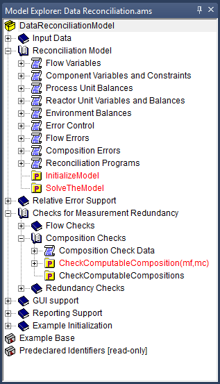

Setting breakpoints in the model tree
Alternatively, you can set a breakpoint on a procedure, function or on a defined set, parameter or variable by selecting the corresponding node in the Model Explorer, and choosing the Debugger-Breakpoints-Insert/Remove menu. As a result, AIMMS will add a breakpoint to the first statement contained in the body of the selected procedure or function. The name of a node of any procedure, function or defined set, parameter or variable with a breakpoint is displayed in red in the model tree, as illustrated in Fig. 36.
Fig. 36 Viewing procedures with breakpoints in the Model Explorer

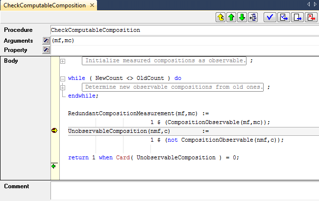

Entering the debugger
Once you have set a breakpoint in your model, AIMMS will automatically stop at this breakpoint whenever a line of execution arrives at the corresponding statement. This can be the result of
explicitly running a procedure within the Model Explorer,
pushing a button on an end-user page which results in the execution of one or more procedures, or
opening an end-user (or data) page, which requires the evaluation of a defined set or parameter.
Whenever the execution stops at a breakpoint, AIMMS will open the
corresponding procedure body (or the declaration form of the defined
set, parameter or variable), and show the current line of execution
through the breakpoint pointer
, as illustrated in
Fig. 37.
Fig. 37 Arriving at a breakpoint

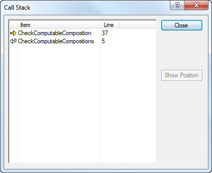

Viewing the call stack
Whenever you are in the debugger, the Call Stack button
on the Debugger toolbar will display the Call Stack dialog box
illustrated in Fig. 40.
Fig. 40 The Call Stack dialog box
With it you get a detailed overview of the stack of procedure calls associated with the current line of execution. It enables you to observe the flow of execution at the level of procedures associated with the current position of the breakpoint pointer. After selecting a procedure or definition in the Call Stack dialog box, the Show Position button will open its attribute window at the indicated line.

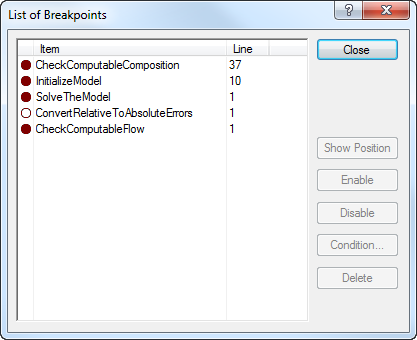

Viewing and modifying breakpoints
After you have inserted a number of breakpoints into your model, you can
get an overview of all breakpoints through the Show All Breakpoints
button
. This button will invoke the List of Breakpoints
dialog box illustrated in Fig. 41.
Fig. 41 The List of Breakpoints dialog box
For each breakpoint, AIMMS will indicate whether it is enabled or disabled (i.e. to be ignored by the AIMMS debugger). Through the buttons on the right hand side of the dialog box you can
disable breakpoints,
enable previously disabled breakpoints,
delete breakpoints, and
create new breakpoints.

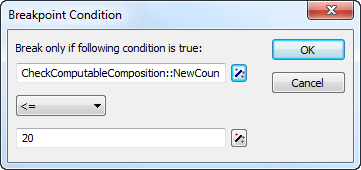

Conditional breakpoints
In addition, by pushing the Condition button on the List of Breakpoints dialog box, you can add a condition to an existing breakpoint. It will open the Breakpoint Condition dialog box illustrated in Fig. 42.
Fig. 42 The Breakpoint Condition dialog box
The condition must consist of a simple numerical, element or string comparison. This simple comparison can only involve scalar identifiers, identifier slices or constants. Free indices in an identifier slice are only allowed when they are fixed within the breakpoint context (e.g. through a for loop). AIMMS will only stop at a conditional breakpoint, when the condition that you have specified is met during a particular call. Conditional breakpoints are very convenient when, for instance, a procedure is called very frequently, but only appears to contain an error in one particular situation which can be detected through a simple comparison.
