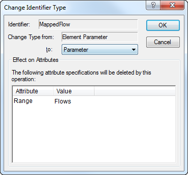

Incompatible attributes
Before a change of identifier type is actually committed, AIMMS displays the dialog box illustrated in Fig. 21, which lists all the attributes of the identifier that are not compatible with the newly selected type.
Fig. 21 The Change Identifier Type dialog box
If you do not want such attributes to be deleted, you should cancel the operation at this point. When you allow AIMMS to actually perform the type change, the incompatible attributes will be deleted.
