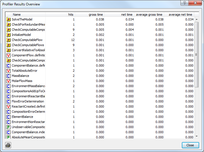

After you have gathered timing information about your modeling application by executing the relevant parts of your application at least once, you can get an overview of the timing results through the Profiler-Results Overview menu. This will open the Profiler Results Overview dialog box illustrated in Fig. 43.
Fig. 43 The Profiler Results Overview dialog box
In it, you will find a list of all procedures that have been executed and identifier definitions that have been evaluated since the profiler was activated.

Locating time-consuming procedures
With this timing information you can try to locate the procedures and identifier definitions which are most likely to benefit from a reformulation to improve efficiency. To help you locate these procedures and definitions, the list of procedures and definitions in the Profiler Results Overview dialog box can be sorted with respect to all its columns. The most likely criterion for this is to sort by decreasing net time or average net time, which will identify those procedures and identifier definitions which take up the most time by themselves, either in total or for each individual call. You can open the attribute form of any identifier in the Profiler Results Overview dialog box by simply double-clicking on the corresponding line.

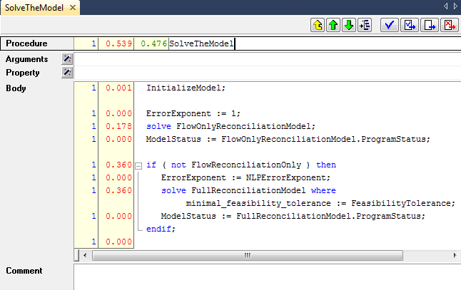

When you have located a time-consuming procedure, you can can open its attribute form and try to locate the offending statement(s). Whenever the profiler has been activated, AIMMS will add additional profiling columns to the body of a procedure, as illustrated in Fig. 44.
Similarly, AIMMS will add these profiling columns to the definition attributes of defined identifiers.
Fig. 44 Profiling information in an attribute form
Profiling column information
For each statement in the body of a procedure, AIMMS can display various types of profiling data in the profiling columns of an attribute form. As you can see next, this information is even more extensive than for procedures as a whole. The following information is available:
the number of hits (i.e. the number of times a particular statement has been executed),
the total gross time spent during all hits,
the total net time spent during all hits,
the average gross time spent during each separate hit, and
the average net time spent during each separate hit.

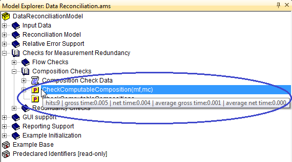

In addition to observing the profiling times in the Profiler Results Overview and through the profiling columns in attribute windows, AIMMS also provides profiling tooltips in both the Model Explorer and in the attribute windows of procedures and defined identifiers, as long as the profiler is active. An example of a profiling tooltip is given in Fig. 45.
Fig. 45 Observing profiling information through a tooltip
Profiling tooltips can provide a convenient method to quickly observe the profiling information without requiring any further interaction with AIMMS. If you do not want AIMMS to display profiling tooltips while moving your mouse through either the Model Explorer or procedure bodies, you can disable them through the Profiler Setup dialog box described below, by unchecking the Show Profiler Values check mark (see also Fig. 46).

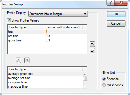

Setting up profiling columns
For every new project, AIMMS uses a set of default settings to determine which profiling information is displayed in the various available methods to display profiling information. You can modify these settings through the Profiler-Setup menu, which will open the Profiler Setup dialog box illustrated in Fig. 46.
Fig. 46 The Profiler Setup dialog box
In this dialog box you can, on a project-wide basis, determine
which of the profiling display methods described are enabled (through the Show Profiler Values check mark), and
per such display method, which profiling information is to be displayed, their order, and their corresponding display format.
The settings selected in the Profiler Setup dialog box are saved along within the project file, and will be restored when you reopen the project in another AIMMS session.
