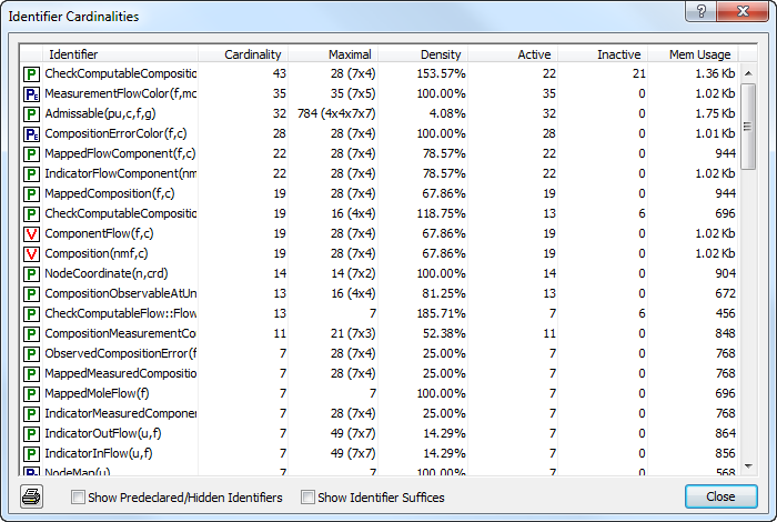

To help you locate identifiers with missing or incorrectly specified domain conditions, AIMMS offers the Identifier Cardinalities dialog box illustrated in Fig. 47. You can invoke it through the Tools-Diagnostic Tools-Identifier Cardinalities menu.
Fig. 47 The Identifier Cardinalities dialog box
Available information
The Identifier Cardinalities dialog box displays the following information for each identifier in your model:
the cardinality of the identifier, i.e. the total number of non-default values currently stored,
the maximal cardinality, i.e. the cardinality if all values would assume a non-default value,
the density, i.e. the cardinality as a percentage of the maximal cardinality,
the number of active values, i.e. of elements that lie within the domain of the identifier,
the number of inactive values, i.e. of elements that lie outside of the domain of the identifier, and
the memory usage of the identifier, i.e. the amount of memory needed to store the identifier data.

Locating dense data storage
You can locate potential dense data storage problems by sorting all identifiers by their cardinality. Identifiers with a very high cardinality and a high density can indicate a missing or incorrectly specified domain condition. In most real-world applications, the higher-dimensional identifiers usually have relatively few tuples, as only a very small number of combinations have a meaningful interpretation.
Resolving dense storage
If your model contains one or more identifiers that appear to demonstrate dense data storage, it is often possible to symbolicly describe the appropriate domain of allowed tuple combinations. Adding such a condition can be helpful to increase the performance of your model by reducing both the memory usage and execution times.
