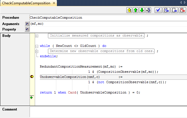

Execution blocks
In addition, you can break down the body of a procedure or function into
manageable pieces using one or more execution blocks. Any number of
AIMMS statements enclosed between block and endblock keywords
can be graphically collapsed into a single block. The text in the single
line comment following the block keyword is used as display text for
the collapsed block.
An example of a procedure body containing two collapsed execution blocks is given in Fig. 27.

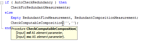

Similarly, while you are referencing a procedure or function inside the body of another procedure or function, AIMMS will provide prototype information of such a procedure or function as soon as you enter the opening bracket (or when you hover with the mouse pointer over the procedure or function name). This will pop up a window as illustrated in Fig. 28.
Fig. 28 Prototype info of a procedure
This tooltip window displays all arguments of the selected procedure or function, their respective data types, as well as their Input-Output status. The latter enables you to assess the (global) effect on the actual arguments of a call to the procedure.
