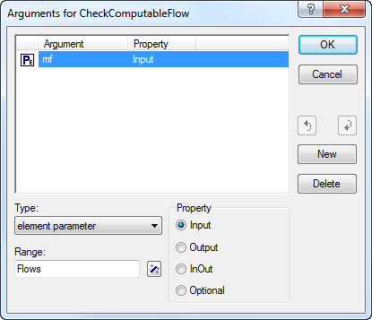

All (formal) arguments of a procedure or function must be specified as a parenthesized, comma-separated, list of non-indexed identifier names. All formal arguments must also be declared as local identifiers in a declaration section local to the procedure or function. These local declarations then specify the further domain and range information of the arguments. If an argument has not been declared when you create (or modify) a procedure or function, AIMMS will open the dialog box illustrated in Fig. 25 which helps you add the appropriate declaration quickly and easily.
Fig. 25 Argument Declaration dialog box
After completing the dialog box, AIMMS will automatically add a declaration section to the procedure or function, and add the arguments displayed in the dialog box to it, as illustrated in Fig. 24.
Input-output type
An important aspect of any argument is its input-output type, which can
be specified by selecting one of the Input, InOut, Output or
Optional properties in the Argument Declaration dialog box. The
input- output type determines whether any data changes you make to the
formal arguments are passed back to the actual arguments on leaving the
procedure. The precise semantic meaning of each of these properties is
discussed in the AIMMS Language Reference book.

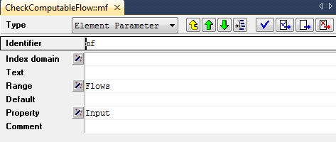

The choices made in the Argument Declaration dialog box are directly
reflected in the attribute form of the local identifier added to the
model tree by AIMMS. As an example, Fig. 26 shows
the attribute form of the single argument mf of the procedure
CheckComputableFlow added in Fig. 25.
In the dialog box of Fig. 25 it is not possible to
modify the dimension of a procedure or function argument directly. If
your procedure or function has a multidimensional argument, you can
specify this with the IndexDomain attribute of the argument after
the argument has been added as a local identifier to the model tree.
Fig. 26 Declaration form of a procedure argument
