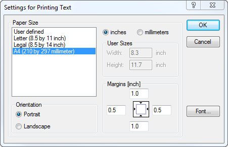

Text files can be printed from within AIMMS, either from the File-Print menu inside an AIMMS text editor window, or through a call to the FilePrint procedure from within a procedure in your model. The print properties of all text files that you want to print, in either manner, can be modified through the Settings-Text Printing menu. This will invoke the dialog box illustrated in Fig. 70.
The **Text Printing** dialog box
Fig. 70 The Text Printing dialog box
Text printing properties
In the Text Printing dialog box you can select the paper type and font with which you want all text files to be printed. For the paper type you can select one of the predefined paper types, or specify a user defined paper type by providing the page height and width, as well as the margins on each side of the page. By pressing the Font button on the right-hand side of the dialog box, you can select the font with which you want your text files to be printed. The text printing properties are stored globally on your machine.

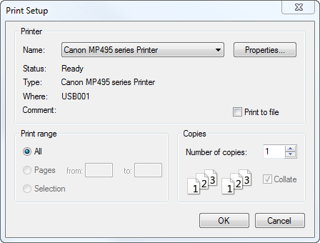

With the File-Print Setup menu you can select the printer on which print pages and text files associated with your project are printed, and modify the properties of that printer. This command will invoke the standard Windows Print Setup dialog box illustrated in Fig. 71.
The **Print Setup** dialog box
Fig. 71 The Print Setup dialog box
Default settings
The settings selected in this dialog box will only be valid during the current session of AIMMS. If you want to modify the default print setup globally, you can do this through the Printer section in the Windows Control Panel. There you can
  • select a Default printer from the list of all printers available on your system, and
  • modify the Document Defaults (i.e. the printer settings with which each print job is printed by default) for every individual printer on your system.
Without a call to the File-Print Setup dialog box, AIMMS will use the default printer selected here, and print according to the document defaults of that printer.
