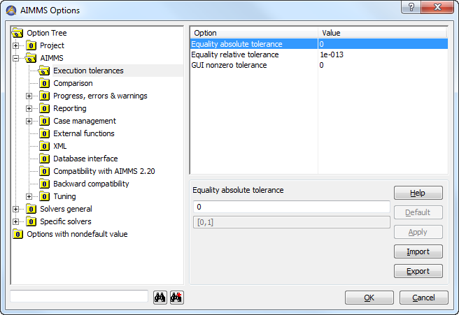

Option dialog box
Through the Settings-Project Options menu you can open the global AIMMS Options dialog box illustrated in Fig. 65.
Fig. 65 The AIMMS Options dialog box
In this dialog box, an option tree lists all available AIMMS execution and solver options in a hierarchical fashion.
Modifying options
After selecting an option category from the left-hand side of the Options dialog box, you can modify the values of the options in that category on the right-hand side of the dialog box. As illustrated in Fig. 65, AIMMS lists the currently selected value for every option (in the first edit field) along with the allowable range of all possible option values (in the second field). Option values can be either integer numbers, floating point numbers or strings, and, depending on the option, you can modify its value through

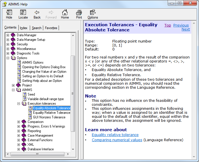

Option description
When you have selected an option, and need to know more about its precise meaning before changing its value, you can press the Help button at the right-hand side of the options dialog box. As illustrated in Fig. 66,
Fig. 66 Option help
this will open a help window containing a more detailed description of the selected option.

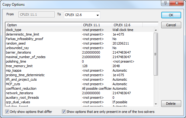

Copying solver options
When you add a new version of some solver to the solver configuration (see Solver configuration for a description of how to add a new solver), the options of this new solver will appear in the Specific Solvers category. To copy solver options from the old solver version (e.g. Cplex 11.1 to CPLEX 12.6), select the source solver in the option tree and select the Copy Option command from the right-mouse popup menu. This will open the Copy Options dialog box as shown in Fig. 67.
Fig. 67 The Copy Options dialog box
By default this dialog will only show options that differ between both solvers plus options that are only available in one of the two solvers. Once you press the Ok button, all options that remain in this list (and are available in both solvers) are copied from the source to the destination solver.
