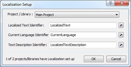

Setting up localization support
Before you can start the final localization conversion of your AIMMS application, AIMMS needs to
add a Localization section to the main model or library module which contains a default setup for working with a localized end-user interface of either the main project or library project, and
register the names of the identifiers and procedures which are necessary for storing, loading and saving the strings used in the end-user interface of your application or library.
You can perform these steps through the Tools-Localization-Setup menu. As a result, AIMMS will add the (default) Localization section to your model or library if such a section has not already been added before. Secondly, through the dialog box presented in Fig. 72,
Fig. 72 Setting up localization support
AIMMS will request the names of the identifiers to be used further on in the localization process to store the strings used in the end-user interface of the main project or library. By default, AIMMS proposes the identifiers added for this purpose to the (newly added) Localization section. If you change the names of these identifiers, or want to use completely different identifiers, you can execute the Tools- Localization-Setup menu again to specify the modified names.

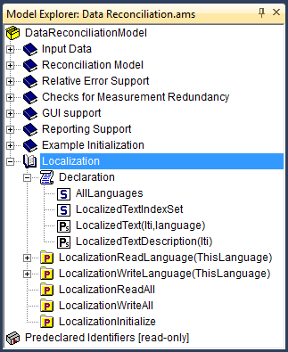

After the localization setup has been executed for the first time, your model or library module has been extended with a new section called Localization. The contents of this model section is illustrated in Fig. 73.
Fig. 73 Localization section in the model tree
The declaration section contained in it declares the default set and string parameters used for storing all localization information.
The set
AllLanguages
contains the names of all languages to which you want to localize your application. You can add as many languages to its definition as necessary. However, you should make sure that, at any time, the first element in the set is your development language: during the conversion process described below, AIMMS will associate all strings in the end-user interface with the first language from the setAllLanguages
.Associated with the set
AllLanguages
is an element parameterCurrentLanguage
, through which you (or your end-users) can select the language in which all texts in the end-user interface are to be displayed.The set
LocalizedTextIndexSet
is a subset of the predefined setIntegers
, and is used to number all strings within your end-user interface that are replaced by AIMMS during the conversion process.The string parameter
LocalizedText
contains the actual texts for all string objects in your end-user interface for one or more languages. During the localization conversion process, AIMMS will fill this parameter with the texts of your development language.The string parameter
LocalizedTextDescription
contains a short description of the origin of all converted string objects, and is filled by AIMMS during the localization conversion.
Using other localization identifiers
Through the Tools-Localization-Setup menu, you can modify the localization parameters which AIMMS will use during any subsequent conversion process. If you choose to select different identifiers, you should make sure that:
the identifier selected for the Localized Text Identifier is a 2-dimensional string parameter, the identifier selected for the Current Language Identifier is a scalar element parameter, and the identifier selected for the Text Description Identifier is a 1-dimensional string parameter.
the second index set of the Localized Text Identifier and the range set of the Current Language Identifier coincide. AIMMS will interpret the resulting set as the set of all languages.
the first index set of the Localized Text Identifier and the first index set of the Text Description Identifier coincide and is a subset of the predefined set
Integers
. AIMMS will use this set to number all string objects during the conversion process.
Localization procedures
In addition to the sets and string parameters discussed above, the Localization section also contains a number of procedures added for your convenience to perform tasks such as:
loading and saving the localized text for a single language,
loading and saving the localized texts for all languages, and
to initialize support for a localized end-user interface.
The statements within these procedures refer to the default localization identifiers created by AIMMS. If you have chosen different identifiers, or want to store the localization data in a nondefault manner, you can modify the contents of these procedures at your will. You must be aware, however, that the facilities within AIMMS to view and modify the localized text entries do not use these procedures, and will, therefore, always use the default storage scheme for localized data (explained later in this section).

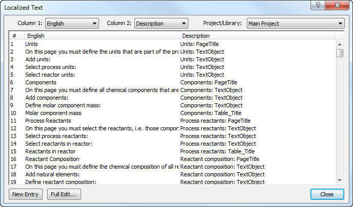

Editing localized strings
Once you have performed the localization conversion, you can view all localized strings through the Tools-Localization-Show Strings menu, which will open the dialog box illustrated in Fig. 74.
Fig. 74 The Localized Text dialog box
In this dialog box, AIMMS displays a numbered list of all localized
strings, along with the description of the origin of each string. The
string numbers exactly correspond to the elements of the set
discussed above.
Modifying dialog box contents
Through the drop down lists at the top of the Localized Text dialog
box of Fig. 74, you can select the contents of the
first and second string columns, respectively. For each column, you can
select whether to display the localized text for any language defined in
the set AllLanguages
, or the description associated with each
string. By viewing the localized strings for two languages alongside,
you can easily provide the translation of all localized strings for a
new language on the basis of the localized strings of, for example, your

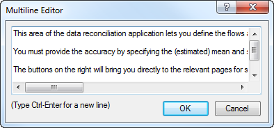

Modifying multiline strings
If a localized string consists of multiple lines, you can invoke a multiline editor dialog box to edit that string through the Full Edit button at the bottom of the Localized Text dialog box, as illustrate Fig. 75.
Fig. 75 The Multineline Editor dialog box
To invoke this multiline editor for the string corresponding to a particular language, click on the localized text for that language, and press the Full Edit button. The multiline editor will now be opened with the exact string that you selected in the Localized Text dialog box.
