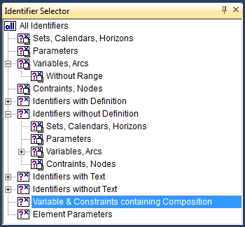

The Identifier Selector
If you need a specific selection more than once, then you can create it in the Identifier Selector tool. The Identifier Selector consists of a tree in which each node contains one of the three types of identifier selectors described below. Fig. 29 illustrates an example selector tree.
Fig. 29 The selector tree

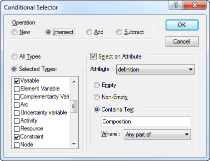

Selection dialog box
To create a selector, AIMMS offers special dialog boxes which let you specify the criteria on which to select. As an example the dialog box for creating a conditional selector is illustrated in Fig. 30.
Fig. 30 The Conditional Selector dialog box
In it, you can select (by double clicking) one or more identifier types that you want to be part of the selection and filter on specific attributes that should be either empty, nonempty, or should contain a particular string.
