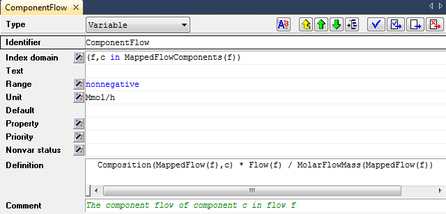

Attributes
For every node in the model tree you can specify additional information in the form of attributes. AIMMS lets you view and change the values of these attributes in an attribute form that can be opened for every node in the tree. An example of an attribute form of an identifier node is shown in Fig. 11.
Such an attribute form shows all the attributes that are possible for a particular node type. For instance, the attribute form of a parameter declaration will show its domain of definition and value range, while the form for a procedure will show the argument list and procedure body. In the attribute form you can enter values that are relevant for your model.
Fig. 11 Example of an attribute form
Wizards
For most attributes in an attribute form AIMMS provides wizards which
help you complete the attributes with which you are not familiar.
Attribute wizards can be invoked by pressing the small buttons
in front of the attribute fields as shown in
Fig. 11. The wizard dialog boxes may range
from presenting a fixed selection of properties, to presenting a
relevant subselection of data from your model which can be used to
complete the attribute.
